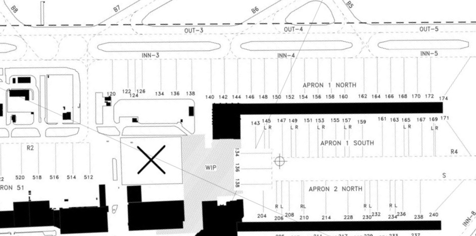

how will you manage the pushbacks from 204, 206, 143, 145, 147 + the new connector stands?Flanker2 wrote: How hard could it be to make a few holes in the wall, draw some lines on the ground and add jetbridges? Just do it!
not to mention you'll increase the risk for the handlers dramatically in that area

The same way you push out on stand 201?
Re: Brussels Airport delays extension of A pier
hmm no because between 201 and 310 are no gates and the situation between Apron 1 south - apron 2 north is different then apron 2 south - apron 3AirOpinion wrote:The same way you push out on stand 201?
There is plenty of room, if they build it above the current tunnel and as much as possible to the West as possible. You can actually put many more gates on the West side, 2 gates on the East side and you still have plenty of room left for pushback.
They may have to re-draw the lines on the ramp there, but what's that compared to building a 100+ million terminal.
Just a simple example:
For handling, they could just extend the way it is along terminal A and B, with a blast-shield right around where the two main taxiways come together, between the black dots you see there.
If you ask me, it looks much better like this.

It's not that easy like you write it here.Flanker2 wrote:How hard could it be to make a few holes in the wall, draw some lines on the ground and add jetbridges
What you show in your drawing is completly not possible.Flanker2 wrote:There is plenty of room, if they build it above the current tunnel and as much as possible to the West as possible. You can actually put many more gates on the West side, 2 gates on the East side and you still have plenty of room left for pushback.
If I see it well you want to put blastfence between pos 204-206L/R and between 145R-147 and 147-149L/R?
What about minimum safety distances you have to respect between a aircraft and an other aircraft/object? It's already sometimes on the legal minimum. Like it's drawn now these stands are never usable again. So your are cutting capacity by 6 stands to create 2 extra?
If it would already be possible, maximum 1 aircraft can stand on the east-side. West-side would be more possible, but not easy either.
It isn't that easy, probably that's the reason why they never gave the option to park aircrafts overthere.
No, the blastfence comes in the middle East side of the connector.
No positions would be lost, but only one of both taxiways can be operated simultaneously, from the point where they converge. This principle is used in many airports across the USA.
It's not rocket science, especially for a new-build. That's what you have architects for.Kapitein wrote:Flanker2 wrote:
That's pretty good. I can see the picture already. Chewing gum ruining the Spanish granite, spitting on the floors, crap in the corners...airazurxtror wrote:At Brussels, the real travellers, the fat cats, the businessmen, have to mix with the LCC passengers, thus chancing to catch lice or another repugnant disease; would you believe that a few LCC pax have even be known to enter a fashion boutique ? Truly incredible but true.
Your configuration is totally different from mine. Your configuration won't work, mine will.
In more detail, with the blast shields in blue, to avoid that the engines would rock vehicles driving along the connector.
The only restriction I see is that the 2 gates will have to be reserved for RJ's.
Notice also that you don't need a 180° push-back, the aircraft can apply thrust and turn by its own, without rocking other aircraft.
Most importantly, look at the West side: how many gates you can win. Like this you can extend terminal T to the West, most pax still pass through most of the shopping mall, and you get a pretty neat airport. Many pax will be able to board directly in the connector, making the walk much shorter for every single pax!
What are they thinking in the project room at BRU

Nice rendering, however, if they place blast shields at those positions they will have to be huge. The blast shields they use while working on taxiways will not do. And even if they would do the job they still have to be placed far back from the actual starting position. A long push/tow will always be necessary.Flanker2 wrote:Your configuration is totally different from mine. Your configuration won't work, mine will.
Real live example (at BRU):
-Due to runway works stand 901 and 902 are unavailable and 902 is even half blocked by blast fences. Standard push back procedure is to push it partly onto stand 902 and then tow till 905 where the engines can be started.
-If the a/c has a non working apu this is no option as the blast will just go over the installed blast fences. In this case the a/c has to be pushed till stand 908 where it can start taxiing.
Note that in both cases it is just a building site behind those fences and not a glass facade with people behind it.

@flanker...
In your design, just take an aircraft, place it onto the newly designed stands and then place other aircraft onto the existing stands... You will see, the necessary space isn t available...
My personal opinion of course
