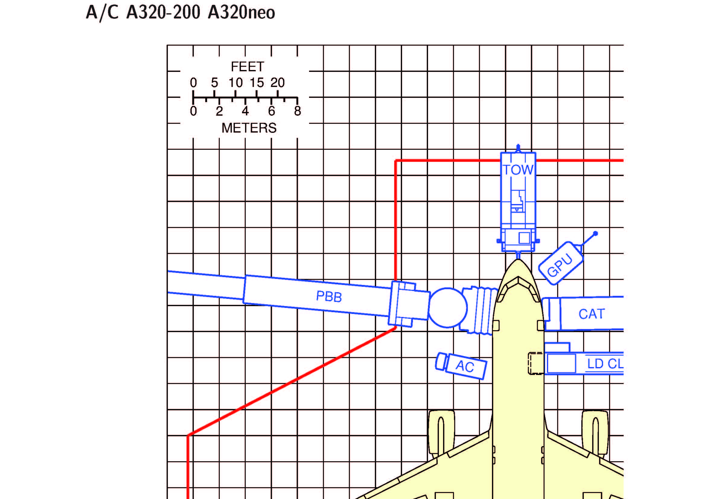

Also if the bridge was well in its parked position as the Notice of Incident says, something is sub-optimal in the design of that stand as the bridge was way too close. The distance between the engine axis and the fuselage is only 3.75m.
The red line on the layout below is the "Stand Safety Line" and nothing may infringe it before the aircraft has come to a full stop..... Looking forward to further interesting reading from GPIAA.
