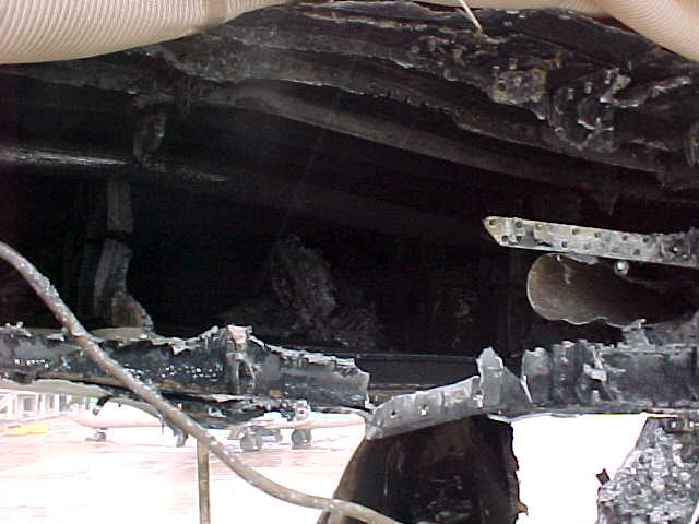

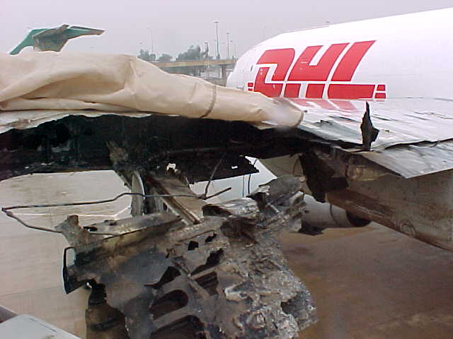

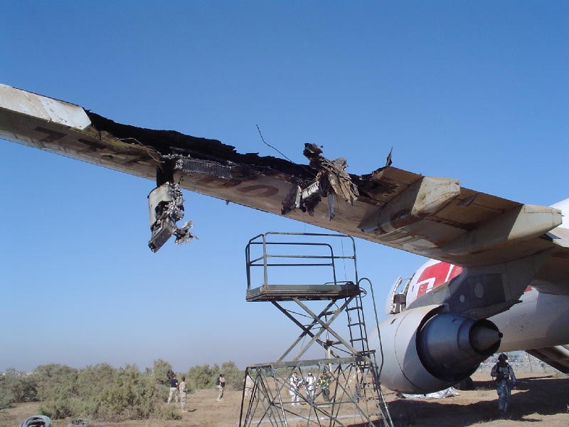

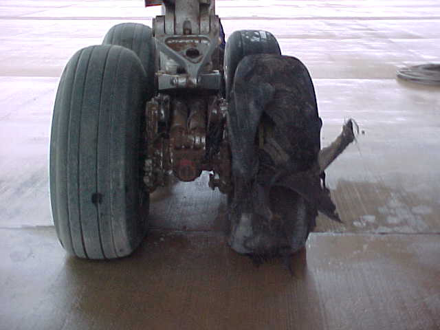

Below is an abstract of the preliminary report of a guy who was sent out to BGW to make an initial assessment.
To those of you who are wondering what happened to the DHL A300B4 coming out of Baghdad last Saturday, take a look.
Aircraft was hit at 8000 FT, lost ALL hydraulics and therefore had no flight controls, actually did a missed approach using only engine thrust and eventually (after about 16mins) landed heavily on runway 33L at Baghdad.
This was fortunate because with no steering the aircraft veered of the runway to the left, had they landed on 33R veering to the left would have taken them straight into the fire station.
The aircraft then travelled about 600 metres through soft sand taking out a razor wire fence in the process, see LH engine pic, and came to rest almost at the bottom of the sloping area between the runway and a taxiway.
All three crew evacuated safely down the second slide, the first one tore on the razor wire.
What he doesn’t say is that the crew basically had to learn on the spot how to make that thing fly !
Also I heard that after having evacuated, the Marines that had arrived on site shouted “Don’t move : Mine field ! “.
Below are some of the pics taken during the assessment.
His report details the extent of the damages.
Basically, LH engine rotates in a fashion, has ingested lots of razor wire and is knackered. RH engine has seized, probably from ingesting loads of sand at maximum reverse thrust and inlet cowl has unacceptable lip damage, probably from hitting the razor wire fence posts.

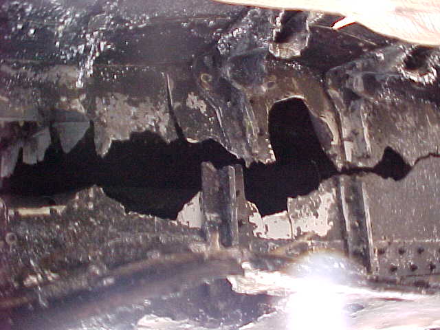

The No 8 axle appears to be cracked as the wheel sits at an odd angle. The bulk of the damage is the LH wing. About 3 metres of rear spar is missing in front of the outboard flap, the wing has bulged upwards and downwards where the initial explosion appears to have occurred, one O/B flap track is hanging in the breeze and one has a small piece of flap still attached, the rest of the flap is nonexistent. The pics show the huge crack that has occurred to the rear spar inboard of where the spar has burnt away, possibly from loads on the wing during the landing process. The front spar appears to be intact.
The point of entry pics show where a projectile entered Tank 1A, which was full of fuel, and, after it ignited, proceeded to burn away at the spar. The fuel tank ribs in the area directly in front of the O/B flap are burnt almost 50% through.
The crew obviously did a fantastic job in getting the aircraft back on to the ground and one can only assume that it was most fortunate that they were not aware of the state of the wing as they could not see it from the cockpit.
It also says a lot for the structure of the aircraft that it withstood the impact of the (whatever is finally determined to have hit it).
