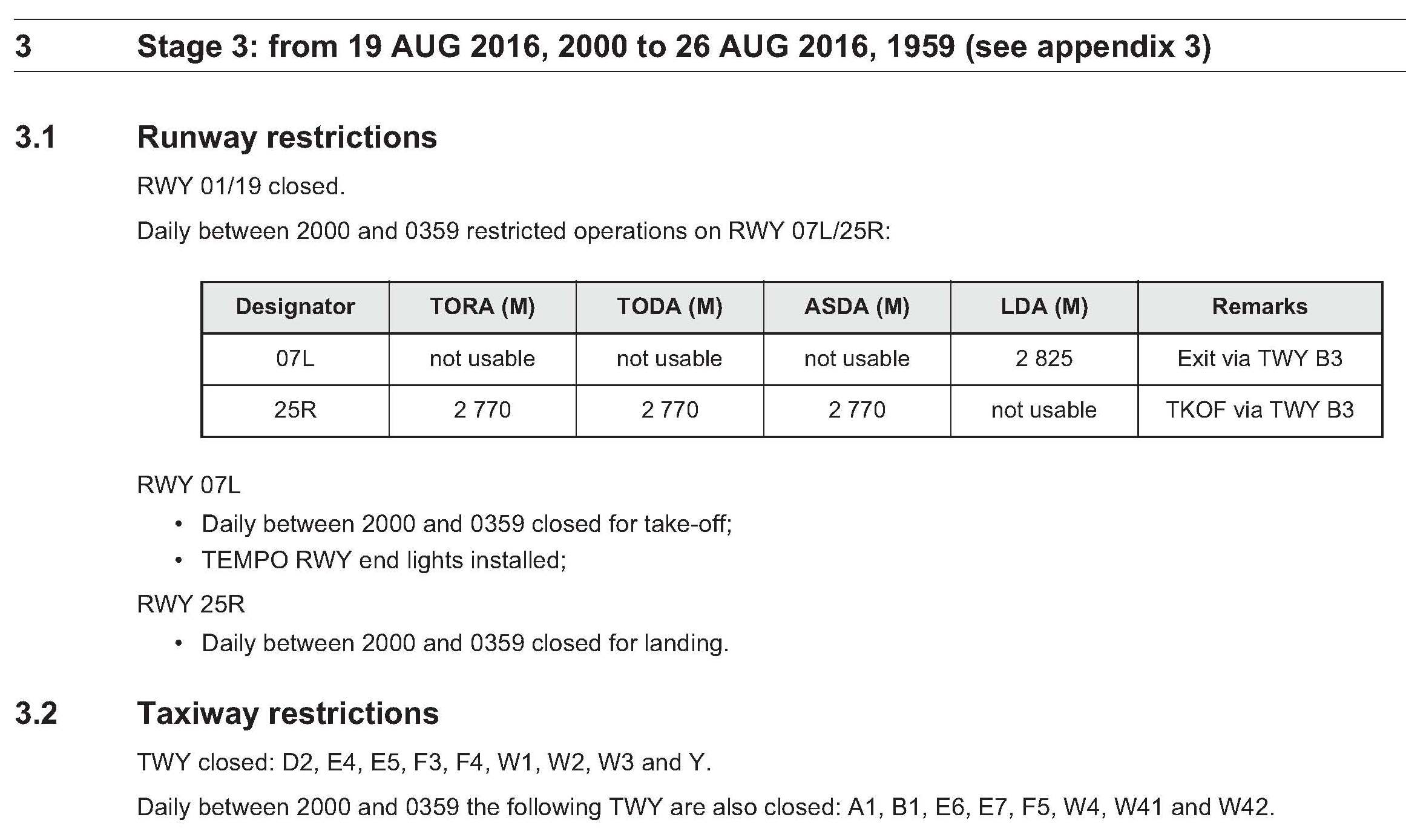

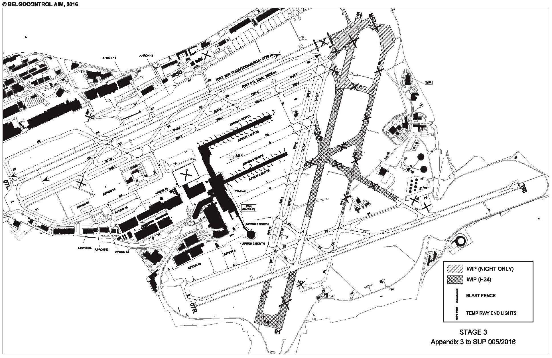

Just to complete the above, Stage 3 starts this evening with little change from Stage 2 though.
Must have been challenging for the heavies to take off from 25R with reduced TORA these last days.

Homo Aeroportus wrote: Must have been challenging for the heavies to take off from 25R with reduced TORA these last days.
Don't forget that we had 07's in use the last couple of days. But indeed today the Hainan had to be told about the reduced TORA and had to offload (after some discussion ;) )
