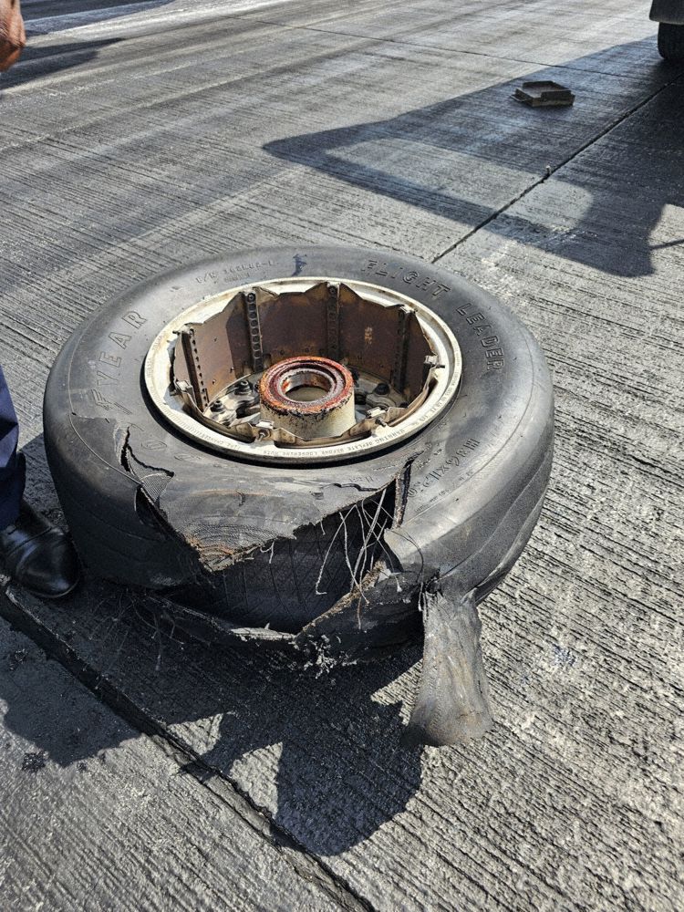

A RwandAir CRJ-900NG made a rejected takeoff this afternoon, following a tyre burst during the takeoff. No injuries. The aircraft was operating the Kigali Harare Cape Town flight. At that time it was operating the Harare Cape Town leg, with 65 passengers on board and 5 crew members.
The tyre was changed on the runway, which led to the closure of the airport with diversions to Bulawayo and Lusaka (Zambia). Airport has reponed few hours after.
The flight to Cape Town was canceled. The Kigali Harare Cape Town flight being daily, there should be 2 RwandAir planes tomorrow in Harare and unsurprisingly it will be a B737-800 (not regular sight like the A330 on this route). Don't know if the CRJ will return to Kigali or will make its flight to Cape Town

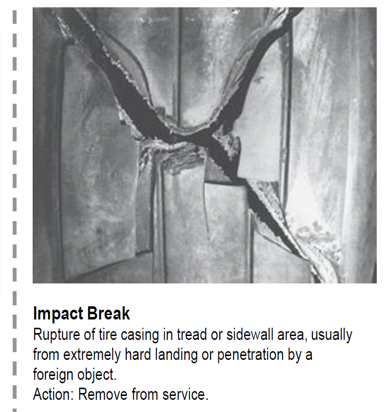

Tyre burst for sure but what was the root cause?
A bit like in some countries, having an argument with a person in uniform carrying a gun may result in a "cardiac arrest".
What is very likely to have occurred here is that a FOD, Foreign Object Debris, lying on the RWY, punctured the tyre, leading to its explosion.
This was a high-energy event where all the tyre casing plies suffered a sudden rupture. The "X" or wide open "V" cut is typical of this type of failure as described by GoodYear.
Rwandair Tyre :
GoodYear Aircraft Tire (americanese for tyre) Care and Maintenance Manual :
Rwandair Tyre :

The aircraft was taking off, so probably a foreign object damage on the runway
