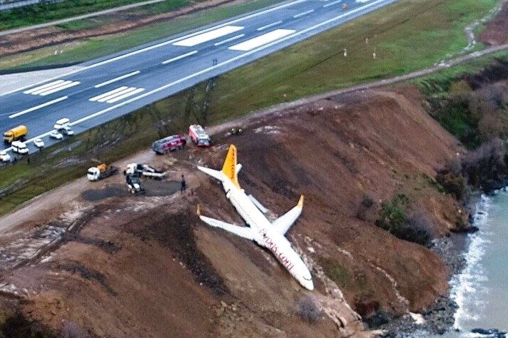

There's indeed an engine broken off, you can see it in the water on some pictures (which also gives a good image how shallow the water is).jan_olieslagers wrote: ↑14 Jan 2018, 18:47 Yes indeed, looking more and more like a write-off. According to wikipedia, one engine broke off to drop into the water - a severe loss, economically.
https://en.wikipedia.org/wiki/Pegasus_A ... light_8622 - but that article has been nominated for deletion.
Purely from a damage point of view I think it will be on the border of a write off. First flight was only 5 years ago, so it's still a fairly recent plane with a decent book value. I can't see any indications of a fuel leak so we can assume the wings survived this incident fairly well. I assume that it all happened at a fairly low speed due to the short distance the plane travelled when it went downhill, so there's quite a big chance that all the gears are intact (yet damaged beyond repair) and that the plane slowly sunk in the mud during the short distance. So I think that the chance that the fuselage itself is virtually undamaged is quite high...
In the end it will all depend on what the insurance will say, will they go for a recovery with a very hefty price tag or will they go for parting out the plane on the spot and recuperating value by reselling undamaged equipment. Even parting out will cost quite a bit, they have to build roads on the slopes to get heavy equipment, cranes & trucks right next to the plane.
They could always go for the cheapest option, leave the plane there and make it into a tourist spot

I suppose the parallel marks left in the mud next to the runway edge are those made by the main landing gear, as the gauge (5.70 m on a 738) appears compatible with the size of the fire trucks nearby.
But I don’t seem to see the track that the nose landing gear should have made between those visible.
On an average B738 (MGW 78 471 kg) the vertical force on the NLG is 7.8 tons, and each strut of the MLG applies 37 tons (max aft CG).
Considering the standard braking effort (10 ft/s²) on the apron, the whiplash effect makes the NLG to apply a vertical force of 12 tons.
These are the values at max taxi weight and in the case of Trabzon she was at the end of the flight but, mutatis mutandis (lower weight on the MLG, max deceleration), the vertical force applied on the nose wheels must have been significant compared to the one on the MLG.
So, was TC-CPF accelerating at the time of leaving the runway?
In any case a close escape. Could have been a bad start for the 2018 stats.

You have keen eyes! Perhaps the pilots kept the nose wheel(s) up for as long as they could? That ought to help in deceleration, by maximalising frontal area.But I don’t seem to see the track that the nose landing gear should have made between those visible.
I heartily agree the outcome could have been much much worse.

If you look very good at one of the photos, you can see that the left wing and the right wing have a different angle. Looks like the right wing deformed. Tail part also detached.

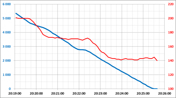

I downloaded the FR24 csv and worked the numbers a bit.
It looks they came in hot.
Straight in, aligned at 18 miles out. CDA but considering that the wind speed on ground was 0-1 kt at that time, +140 kts GS seems a bit high no?

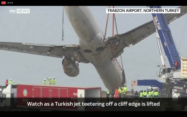

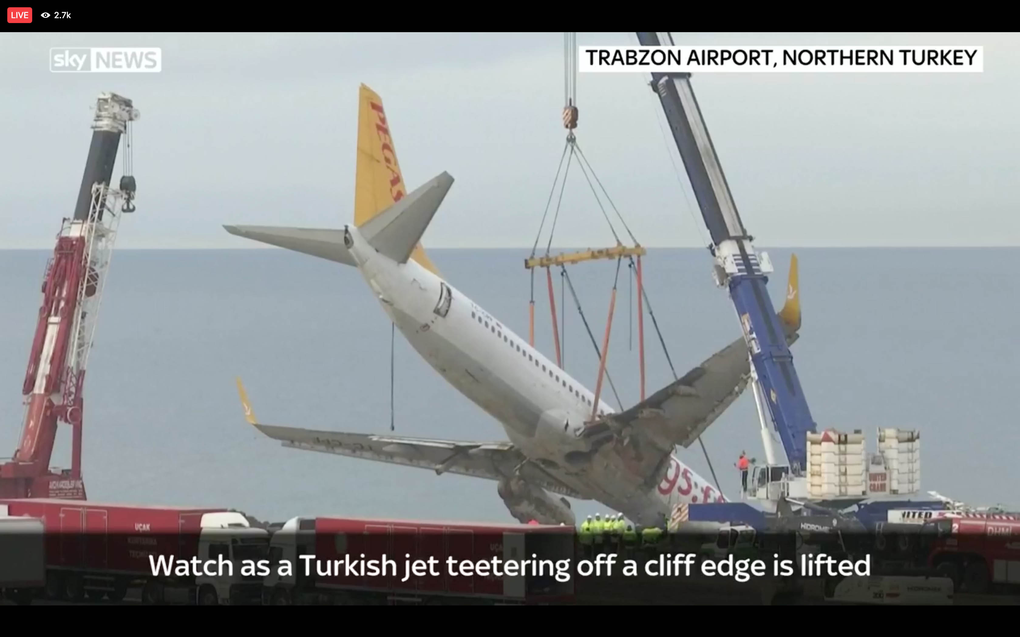

LIve stream via: https://www.facebook.com/skynews/videos ... Mw4F1b-168
They simply lift the aircraft, hull loss ?

Seems they stabilised the ground for the cranes to be able to position close to the edge.
Seems that the plane is less damaged than I thought:
Re: Pegasus Airlines off the runway at Trabzon; Boeing 737-82R registered TC-CPF
Damage to the belly doesn't seem to bee too bad. I anticipated worse... But pictures do not show enough detail to see wrinkling and or buckling of the fuselage. That will help indicate how far of it will be from a hull loss. Though the right gear and pylon being ripped off, are not a good sign. But if the fuselage is still straight, and the structural damage to the wing is repairable, it might have a future yet... Big "ifs" though...
