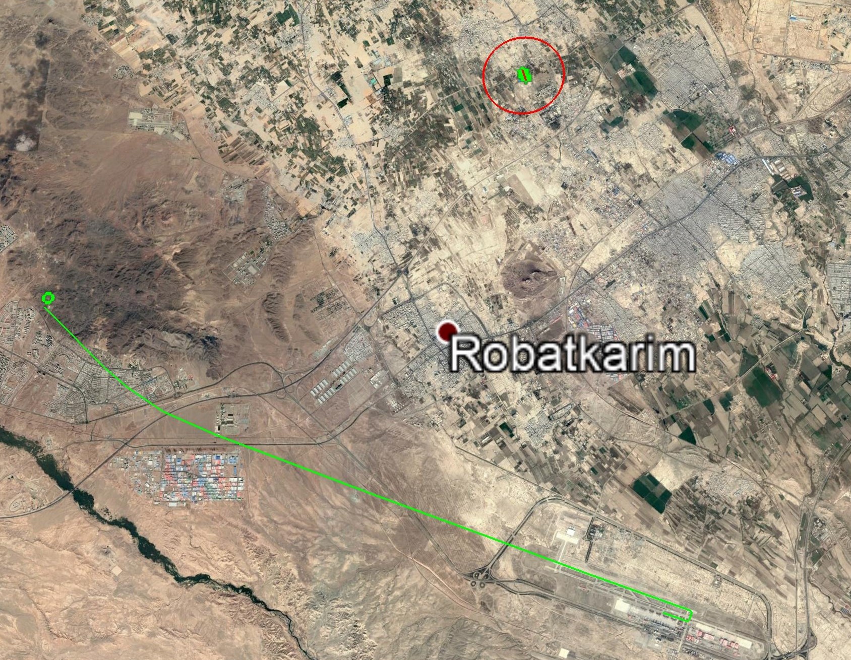

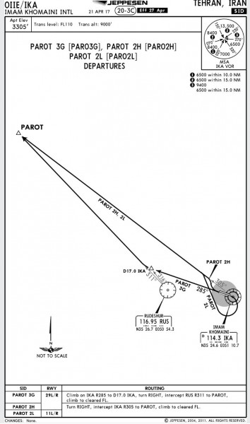

Flight path per FR24. Similar to previous UIA flights up until near the end where the data stopped being transmitted (green line and dot), 3 minutes after take-off.
The red circle marks the crash site which is about 16km in a straight line from the last XPDR transmission.
IKA airport in the bottom right.

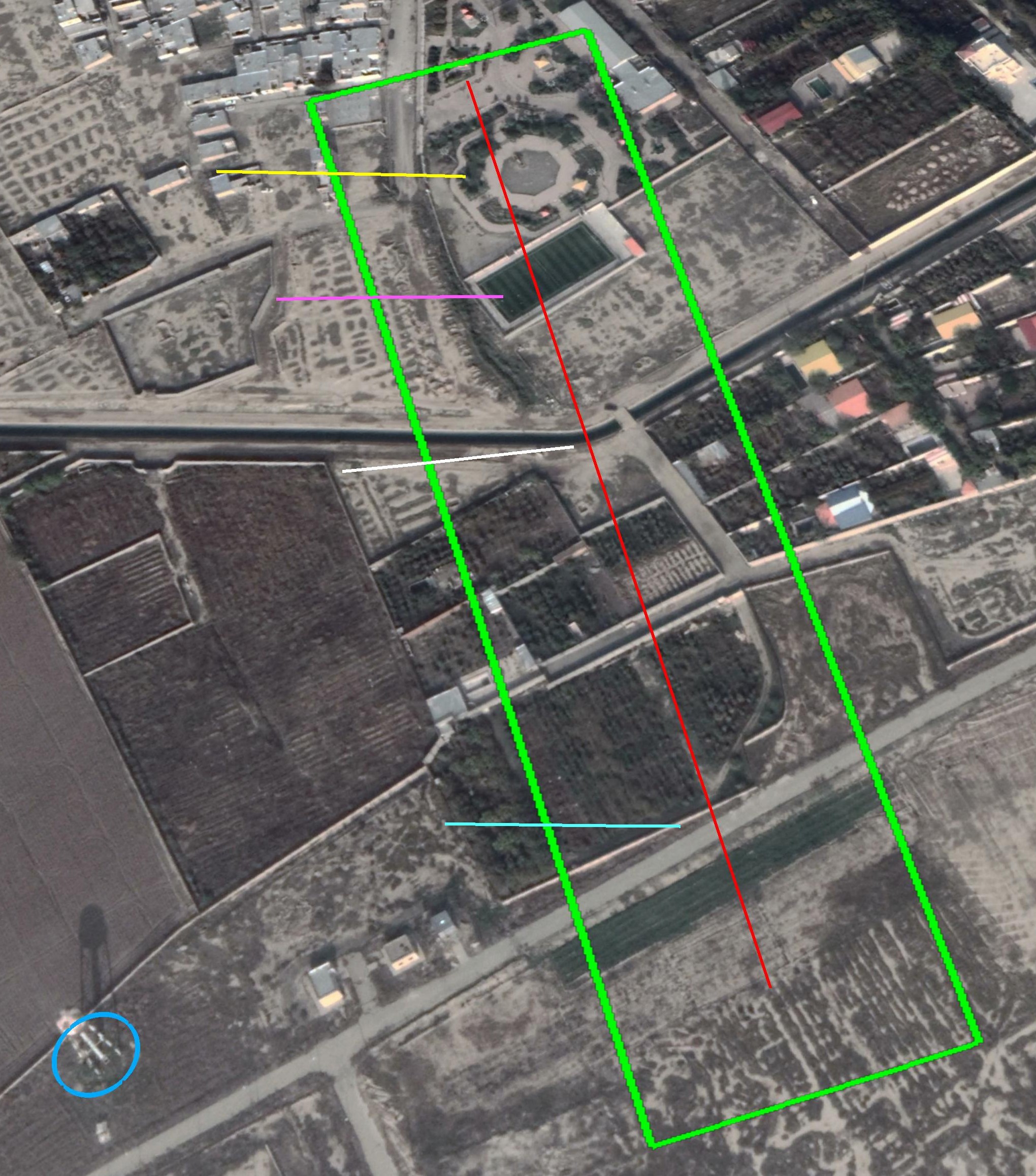

Crash zone below. Debris scattered along +400m. Coming apparently from the NNW, heading about 160° in a possible attempt to return (if the flight was still under control).
From top to bottom : the octagonal pavement (yellow line), the football pitch (pink line), the canal (white line), and further south the walled parcel with one rounded corner (blue line).
In the lower left corner of the GE pic is the water tower (blue circle) that appears on several photos further down. It is about 200 meters from the crash site axis.

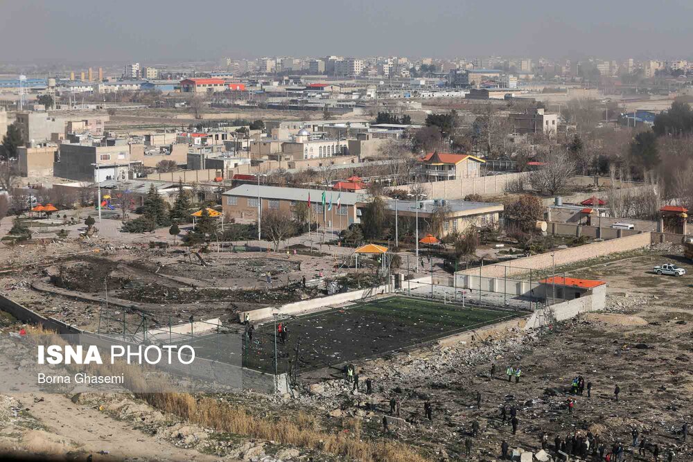

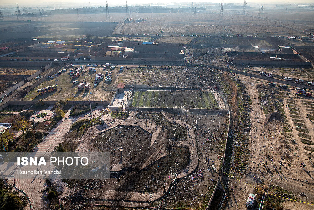

First (visible) contact with ground, looking SSE. Octagonal pavement and football field.
Note the narrow opening in its wall.
From reverse angle :

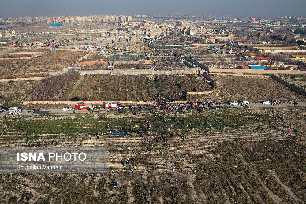

End of the crash path, looking towards NNW. Note the vertical stabilizer in the centre left of the photo, at the border between green and brown soil. This point supposedly marks the front end of the crash zone in the direction of travel. The aircraft is disintegrated but the VS has “flown” forwards ending in front of all the other debris?
And what do you make of this myriad of debris? High energy impact or disintegration in flight?
I’m puzzled by one thing.
The transponder data abruptly ceases being received just after the moment the flight path went slightly right of the normal course, but without marked disruption in both altitude (climbing) and speed prior to that.
At that point the altitude reported was 7925ft. Field elevation is 1000m or 3300ft, so they were 4600ft/1400m AGL and no obstruction. It must have taken at least 3 minutes to reverse course and crash where she did,
I don’t know how the XPDR is powered on a 73, (from the bus supplied by the generator on engine 1 or 2 ?), but I seem to remember that on an A32S, even if you lose one engine or at least that its IDG drops off, the Tie Bus Contactor automatically activates and the other engine will supply immediately both Bus 1 and 2. I guess it is the same on Boeings, no?
So what may have caused the transponder to suddenly stop transmitting?

I cannot know, and I dislike speculation, but to answer the question as asked, one possible reply might be that it was switched off.So what may have caused the transponder to suddenly stop transmitting?
